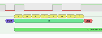

I've connected the logic analyzer and even though the cheap SAM2695 based synth I've connected doesn't make any sound, it seems to me the MIDI messages are fine. When running your MIDI_IN_OUT_TEST I immediately see a byte $FA being sent at 31250 bit/s which seems to be the MIDI "System Realtime: start" message. Further down I see frequent $F8 which are seemingly "System Realtime: timing clock" messages. And then there are a bunch of more complex messages now and then. I am no MIDI expert at all. But technically, this seems to make sense.
What _should_ happen if I connect a synth to your test?

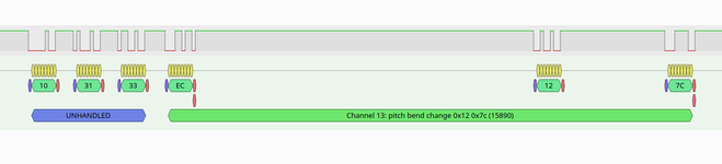

This is e.g. how the trace looks:
Edit: This trace actually does not look right. There are frame errors e.g. at the end of the EC byte.
This is a byte as being sent by M immediately after system reset:
You see that the signal changes at the top row don't exactly match the expected timing, shown by the changes between 0 and 1 in the second row. The top row would be a bitrate of ~29000bit/s instead of the 31250 MIDI uses.

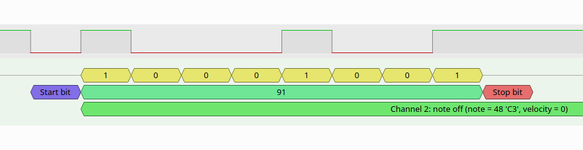

And this is how it looks when cubase is running:
Here the changes are correct and happen exactly at the right moment. And if I run M after Cubase it looks like this:
Here the timing is still correct.
It seems that there's something in my NanoMig that M doesn't initialize and its default state after reset is not what M expects. Cubase then adjusts this and afterwards M also works. Interesting ...
