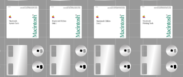

• full set of Mac branded stockers for matchlock and floppy disk

Mac branded stickers:
