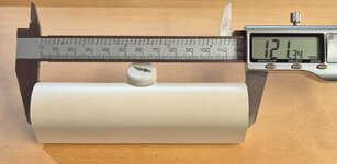

Following up on this... I do think it would be possible without too much hassle. Here are some pictures of the original stand components...
First, the part that mounts onto the bottom of the CRT :
As you can see, its just over 121mm wide. Looking at your front bezel, that equivalent part of your model appears to be 140mm. Could you alter this to be 121mm?

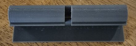

So I decided to do a little hacking about on the bezel... sorry @ArjenCNX, hope you won't mind!
First I cut off most of the bezel in my slicer, and then removed about 9.5mm from both ends of the 'mount'. Here's what it came to before slicing.
...then printed...
...then a test fit...
Now... I did have to drill out the hole to 1/4" so the threaded rod would go through (and since that's a drill bit I had to hand). As you can see the 'barrel' is much smaller than the original CRT mount, but I think with only a few minor tweaks, this would work well!
Here's a pic of the hacked mount end-on...
If it's not too much effort, could you increase the 'barrel' diameter to 30mm, the hole size to 7mm and reduce the length(width) to 122mm? With those adjustments, it should be a good fit both physically and aesthetically... and you'll probably only need the front bezel and back to mount the LCD on the //c CRT stand. :) Thanks!!
