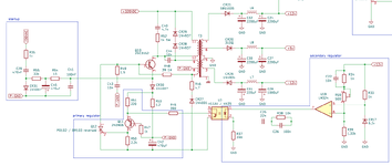

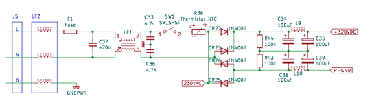

Thank you for all the advice. By fixing the AC section which parts do you suggest me to concentrate more?
Check this thread.
The AC section are these ones:
I had to replace those four big caps (C34, C35, C38, and C39) in my INTERNATIONAL AB because they were bulged. I recommend checking everything (resistors included) and replacing the four diodes of the bridge rectifier without hesitation; I would also check if CR31 is okay.
With a little patience and luck, you should find one or more faulty components in this section.

I did indeed spend some time testing everything in the AC section. CR31 is indeed faulty, and also is CR30... with all these faulty components I'm starting to be amazed this thing even turned on a couple of times! I will also change the capacitors, for good measure.

Since you've got AC voltage past the thermistor, start moving downstream. Check for roughly 320VDC across the positive pin of C35 and the negative pin of C39. If it's there, keep tracing the DC rail until you find where the voltage drops off. Did you check Q10 and Q11?. Your symptom sounds like either the DC stage is not starting up or you still having problems with the diodes CR21 / CR20. First check DC voltages at the inputs of T3 (Mainly the primary coil, the one with inputs P11, P12). The problem for sure is this section:
