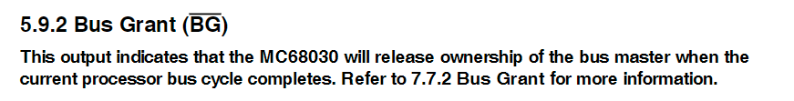

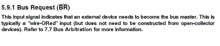

They disconnect /BR and /BG. There's some note in apple documents as it being part of the burn-in testing and to never remove in operation. Had the same question myself.

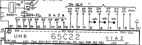

Ah, interesting! I was too blind to find it myself in the Bomarc schematics. The AI assistant in Adobe Reader was completely useless, too:
So instead, I used @max1zzz's IIcx reloaded board file to trace out where they go, and sure enough, there it is in the Bomarc schematics. It's hooked up to pins 5, 6, and 7 of UH6 (VIA2).

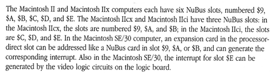

These pins are also known as PA3, PA4, and PA5 of VIA2 and also go to pins on the GLU chip. Luckily, Guide to the Macintosh Family Hardware 2nd edition tells us what they are. They are interrupt request lines for expansion slots $C, $D, and $E.
And more useful info from the same book...
So after all that, I can say that it looks like they are the IRQ lines for the three other NuBus slots that aren't available on the IIcx, since the NuBus slots it actually has are $9, $A, and $B.
