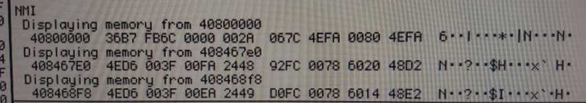

Through debugger, do a DM 408467E0. And also a DM 408468F8. Share the output here. The first two bytes of each should be 4ED6.

@luRaichu, DM 400467E0 and then DM 400468F8 from the debugger (MacsBug or MicroBug). You'll want to use these addresses that start with 400 instead of 408. Let's at least confirm that the first 2 bytes of each display the patched 4ED6 bytes.
Well that is interesting, and at least not what I expected. Do a DM 40000000. Let's see what the first 4 bytes (ie checksum) is for the ROM. (Or check TattleTech or something similar to get the checksum that way)
Is it easy for you to install a program like TattleTech? Under General you can scroll down to the ROM section and get some really useful info like ROM Checksum and ROM Start.
Also 0x02AE is the ROM base global. So you could DM 2AE to see what that shows too.

Are you running in 32-bit or 24-bit mode in these examples? You wrote that the 32-bit addressing option "appears", but was not clear to me if it actually was enabled or not.
The address map (figure 3-7) represents the 32-bit "physical" address map, and the "DM" command operates on logical addresses if I'm not mistaken. Consequently, in the event that you are running in 24-bit mode, "DM 400467E0" would be stripped to "0467E0" and you would end up RAM instead.
Sorry, I was in 24-bit mode.
ROM base is 40800000.

Right checksum for the IIsi. Also I think those two additional DM's show the right patches to bypass the memory testing. So....... Not quite sure why the cold boot with this ROM = the cold boot with your onboard IIcx ROM. Nothing odd plugged in, accelerator cards, invalid PRAM, etc etc?
