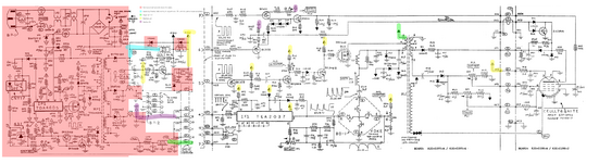

Finally, after the troubles i had in this thread, I'm now able to power the early Mac Classic's analog board with USB Type C!
(Right now im using its fixed up logic board that is also powered by USB Type C for demonstration purposes).
Final aim is to make it like what they did here. But with a Raspberry Pi 4.

Also the analog board voltage hooks schematic buried in the previous thread:
WARNING: If you don't know how to deal with high voltage stuff, please stay away from this thread. I am not liable for any lethal/non-lethal injuries or damages resulting from the use of this information.

I've modified `dtparam=vactive=342,vsync-invert` from 342 to 384 to have a proper 4:3 aspect ratio. After adjusting the vertical size potentiometer it seems to work well!
