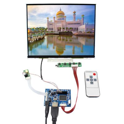

Thanks so much! Yep, the diagonal of the pixels is what I needed. That screen is a bit less than 271mm in diagonal. Just need to match aspect ratios. Drawing the rectangles on oversize cardboard to hold behind the bezel will be the next step, thanks so much!
