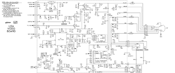

I'm trying to figure out the best way of fixing that outside of just adding a film cap to move the screen without adjusting the horizontal phase potentiometer. While checking through the comments through the video, I saw two recommendations:
1. Replace R4 and CR1 with a 7805 regulator
2. Put a tant/ceramic cap bypassing CR1 to "smooth" the signal out.
What's the best option here in terms of fixing this issue? Below are the schematics on the video board.

Alright, I end up trying to do the bypass caps first.
Got two 0.1uf ceramic caps, put one bypassing CR1, the other bypassing C3 on my Apple Lisa video board.
Results: seemingly no change, there’s still a ripple through the video. Will have to see if replacing the Zener fixes it, and if not, just replacing the entire circuit with a 7805.
I gave up, I ended up just finding two film caps and soldering them to the back. Everything looks good now.
