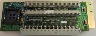

Also a lurker happily watching the development of this. If you need a SuperMac Dual PDS adapter for IIsi or Daystar IIcx adapter to assist in your research, let me know. I don't know if they work as I've never tested them, but they look clean. I also have Micromac DiiMo IIsi / Iici adapter (same as the image you posted initially), but its presently wedged into my SE/30 - I can take higher res pics or something if you need.
Attached is image of the SuperMac adapter.

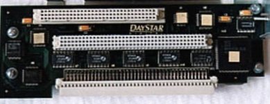

Also I do have that Daystar IIcx passive adapter as well if that aids in this. Some scorch marks on it (above a bad cap?) but traces look intact- can't verify though as I have no IIcx.
Hey, thanks for the pic, looks like it might be yet another anomaly. Does the IIcx adapter have a socket for the MoBo's 68030 on the other side? I don't see what should be obvious evidence of the socket for it, very strange. I remembered mine being passive, but never took note of the details of the setup. I just bought the ones I could get inexpensively during Shreve's massive clearance sale in case I ever found a PowerCache or as cheap sources of connectors in the case of the passive LCIII versions.
Lately I've been hoping that the GAL on the IIx adapter will be all we need, that's another gut reaction without any real substantiation. I didn't see any obvious reason it shouldn't, but that IIcx anomaly has got me wondering a little bit about it. If you can buzz the connections for me there's no need to take/send your adapter anywhere at this time. I should work at recruitment for that end of the project, but it looks like I may have one volunteer for doing the firmware dirty work. If I'm even up to it at all, that's going to be one tough row to hoe, the more I read about it, the more I think it's best to hand that entire process off to someone competent, but it's way fun to learn about it!

No socket on the IIcx adapter, it just wires up the 68030 straight to a powercache slot. I bought it with a daystar 68030/50 board (the 'P33' labeled variety, the one that works directly in IIci). Attached is photo of other side.
