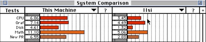

With everything now working properly, I thought I'd try to speed up the purposely-slowed-down IIsi (so as to not compete with the IIci), so I upgraded the oscillator to 50 Mhz and added a TechWorks PDS FPU/Ethernet card (from Herb's Stuff). After some tinkering around with the disk cache and IIsi-RAM-Muncher, I was able to get a Speedometer 3.06 score of 6.55 compared to 2.83 for the stock IIsi. Even with that impressive score increase, the IIsi is still very SLOW doing anything having to do with the internet. I guess that shouldn't be surprising given that it came out before the internet really took off...

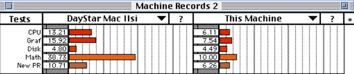

I was able to find a DayStar IIsi cache adapter / PDS passthrough for my DayStar accelerator - now running at 50 MHz! It's getting a bit crowed in there with the Ethernet card...
Here's the upgraded Speedometer score:
The IIsi is much more usable online now!
