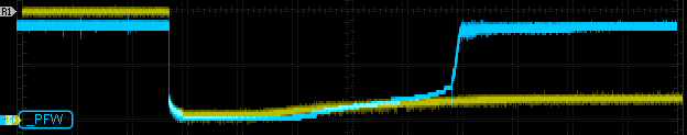

Here's a closer look at /PFW and +5V when the "turn back on" happens. (They're both perfectly overlapped so you can't see the marker for +5V, but it's yellow). The turned-off 5V rail has only dropped to about 1.2V when it powers back on. /PFW has gradually crept its way right to about the same level, which is enough to turn on the 45 transistor. I'm assuming really low current means the diode drop across D3 on the logic board is also really low. But...is the diode drop low enough that the yellow line seems to get all the way up to the pink line in my capture?
If the diode drop is really supposed to be larger than what I'm seeing, maybe something else is accidentally leaking power onto /PFW?
