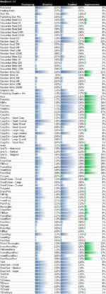

I tested with MacBench 3.0 since it shows more tests and they're less noisy than Norton. Results are shown as a percentage of stock SE/30 numbers. Drawing functions involving curves and arcs seem to benefit the most, probably because they're too large to fit into L1.
A negligible improvement from shadowing may indicate the trap has been patched by System 7.1 and is already SDRAM-resident. The figures in the "Disabled" column are from a mix of ROM and SDRAM resident traps.
