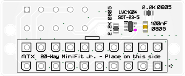

@Jockelill I do have some spare 'kits' (populated board + connectors + switch ready to solder) in France I could let go, PM me. You probably should double-check the GitHub design first to make sure all is OK with you (the soft-power circuit is as yet unconfirmed to work, it's dead motherboard-side on my IIci).
Folks looking for the 10x2 molex and want a genuine molex part, the "39-29-9202" is much cheaper then the "39-29-9205" identified in the parts list. I think the 05 is gold plated, hence the price.
I'll have a few spares in a out a week's time in the UK. The attached is using the more expensive molex part. Next week's will be using the non-molex brand 10x2 connector, and be in black :)

Oh man! Be careful everyone. @MrFahrenheit noticed that the gerber files are incorrect. The transistor is rotated 180 degrees. I think they fixed the error when I had my board made, but I suggest you check your boards.

MrFahrenheit's changes we're rolled into the github at the time. It isn't a transistor. It isn't the gerber that was rotated, it was the pick and place file.

@Phipli Oh. Well, mine showed the 5 pin thingy (voltage converter?) was rotated 180 degrees. I didn't notice. But it looks like JLCPCB noticed the error and fixed it before assembly. So I think crisis was averted.

That little fellow is an inverter, the soft power signal on PCs is inverted compared to old macs so you need to flip it so that the computer doesn't power on /unless/ you're pressing the button!
Glad they spotted. The files should be updated now, JLC also recently changed their formatting and didn't really deal with it very well. They just told people that things were formatted incorrectly, things that they had accepted a week before with no issue.

I've had that issue a lot with JLCPCB, the rotation in the pick'n'place file is predicated on the original orientation of the footprint. If the one from your tool is different from the one JLCPCB uses, chaos ensues. I have designs where nearly everything not a passive has to be re-oriented in the website... Now I just had some very explicit '1' or such markings where JLCPCB's pink dots are supposed to go, makes things easier.
Which I realize I didn't do for the 1G04 in my own version of the adapter. BTW, I've had a report soft-power works, so both position of the switch are OK (soft-power or always-on).
If anyone wants to build a bunch of these, and needs at least 10 of the ATX connectors, I have 50 of the "wrong type" which I sourced before finding out the PCBs needed to be adjusted for them. I'm told the PCB design on GitHub currently has spacing for both types of connectors in the same design, but I haven't verified this myself (I ordered the old style).
The initial project had the ATX holes in a specific spacing, and quoted a particular ATX connector part. I was assisted in obtaining more affordable parts, which included an ATX connector that had spacing which wasn't the same as the original design (of which I had pre-assembled PCBs coming for). So instead of re-ordering a batch of PCBs, I instead ordered different connectors to fit the PCBs I already had in production with JLCPCB.
So I have a box full of the ATX connectors I cannot use. If anyone wants at least 10, I'd be happy to drop some in the mail to you (US only) for $8 USD including shipping costs. If anyone wants all 50, I'll sell at my cost plus shipping. DM me.
There are two designs on the github, you need to select the "alternative" named design for the Chinese 2x10 connectors.
They are confirmed to fit.

I'm considering organizing a group soldering party to build a few of these. Could somebody please help catch me up on differences between the different versions? Is this correct:
Original Version by George Rudolf - https://github.com/GeorgeRudolf/OldMacATX
  • two-layer PCB
  • 0805 SMD components
  • uses Mac's soft-power on circuit
  • "alternate" PCB version supports real Molex 10x2 connector or low-cost Chinese 10x2 connector
@Melkhior Version - https://github.com/rdolbeau/IIci_ATX
  • four-layer PCB
  • 0603 SMD components
  • has a switch to select between Mac's soft-power circuit or always-on behavior
  • has a power-good LED
  • 10x2 connector support???
