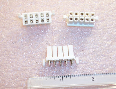

Those are Molex 15-24-7101 rather than 15-24-7100. Any idea what the difference is?
I did a while back, but forget specifically. Part number changes for plastic colour, pin coating and some other stuff.
It's a datasheet trawling thing to check. Not helped by a large number of errors on supplier websites (they list the wrong drawing for similar but different molex parts).
Basically, use the molex site, not digikey/mouser/farnell.
