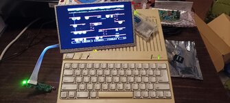

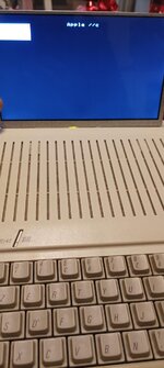

Simply using the composite out, I have some result on my PAL IIc:
and it seems even better on the (NTSC) IIc+ , even if this Dino Eggs pic doesn't really seem so good:
The best results so far are through a longer chain: I used a PAL video out card, with a SCART-out cable connected to a SCART to HDMI box that I usually use with my IIGS, and then I connected the panel using an HDMI cable. Colors are brighter, pixels are more defined, 80 columns text is way more readable.
