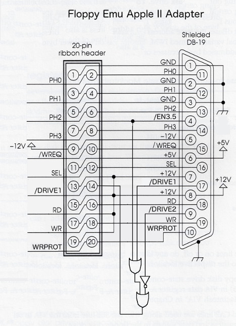

Looking for some help with the pinout of the IDC20 connector on the FloppyEMU / Macintosh LC575. I am setting up a FlippyFloppy from the magical Kay Koba, but I want to use a DB19 connector instead of the IDC20 cable. This is purely for aesthetic, and completely form over function. I'll be wiring the DB19 cable to essentially just be an extension from the FloppyEMU to the FlippyFloppy connector, but I'm losing a pin because DB 19 has 1 less pin, and I'm not sure what pin I can drop from the IDC20 connector. I'm looking for some help with which pin I can drop from the IDC20 connector / which of the 20 pins can the FloppyEMU and Macintosh floppy still operate without?
