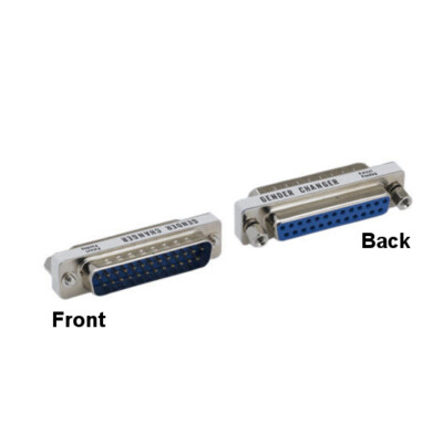

I think you can just use one of these :
No, I don't know why they exist either :ROFLMAO:
To make your cables fit together ;)
This is what I did. 1 or 2x straight through gender changes attached to my older 25pin SCSI2SD did the trick.
