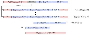

I guess you've scanned earlier comments so you know we've been talking about the Sun MMU (because Melkhior is developing a Sun on an FPGA and because I sometimes play around with toy Virtual Memory algorithms for ARM-26, '286 and Interdata 7/32 architectures). Perhaps I'm wrong, but when we looked at the Sun docs on the Sun 2 MMU, SUN refer to the FC-2 behaviour as address spaces:

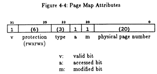

Sun's MMU also describes it as supporting segments, but in fact these are just second-level page tables (it's a 2-level system). They're not segments in the Multics, 80286-x86 sense. Similarly, architectures like the pdp-11 and Interdata 7/32 talk about supporting segments, but this is also misleading. You can't use them to implement Multics, they're just variable-length bank-switched memory systems (like the 'MMU' on the Z180).
