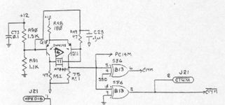

14.3mhz clock signial works fine going to B13 on all pins it's expected.
It's not LEAVING b13 though.
SSD/5SD/55D whatever it is is deadline flat. It's dead on D11, D10, A11 so it's not just B13 having the issue.
The problem I'm running into, what in gods name is SSD/5SD/55D
Any ideas?
Edit: God bless the reference manual
S5D is the following:
Location Pin
LocationPin
A913
D104
D105
D106
D107
D114
D1113
A111
A114
But all of those seem to be input, not production. hmm.
Resistors! Will be just honestly replacing all 4 of them on the new board.
It's a lot cleaner, seems to have less issues at first glance.
Will start mix matching chips between the two of them.
I do need to buy more sockets though, as some of them are coming out of the board / broken.
