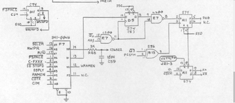

Anyone else looking at the schematics:
Know if that's expected or where a 1mhz clock signal would come off?
I decided to take another look at the video logic again.
Seems it "starts" with D4? Right?
Both show C1m, the 1mhz clock signal?
I get a 60hz wave there (expected..?)
Ignore pin 10 and 11 of B12? Or seems wrong?
