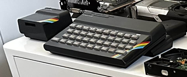

I did notice the ZX Spectrum with Interface 1 and a Microdrive!
For those not in the know, the Sinclair Microdrive was a soft-sectored, tape-loop thing using video-tape quality tape. It was cheap (just £50/drive), but it stored only 85kB per cartridge and whizzing the tape through the mechanism would fairly quickly wear it out. Surprisingly, I still have many that still work!
