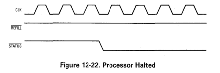

Checking status again, status is low, halt is highLooking at the '030 DS: STATUS should provide some clue of what the CPU is attempting to do - it literally shows the outline of what the core is doing. By forcing /HALT low you should be able to make the CPU show /STATUS also permanently low. You can try that. If that doesn't do anything, I'd reflow the CPU's clock pin, and the oscillator's clock output, etc, just for giggles, and if that does nothing...uh.
With halt not pulled low, status is stuck low and reset doesn’t effect it.Ok, if /STATUS is low then it's permanently asserted and the CPU is telling you it's taken a double bus fault. If it's taken a bus fault you should see more signs of that. I would think you'd see some sort of address line activity, not just one pulse at reset - are you perhaps running the scope too slow for those signals?

Wait something is inconsistent. Status is staying low when I pull halt low but not always. CheckingSo /STATUS just goes high if you tell it to halt? That seems broken, it's the opposite from what would be expected. View attachment 58955
