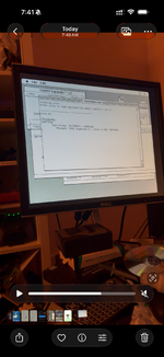

TattleTech still couldn't locate the card during any of these trials. But I doubt I can expect the FPGA to function with that sort of clock input to it.
