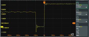

The first picture is the /START signal on the IIfx asserted by the NUBUS master. I have the trigger set to roughly 0.8v, and you can see that the LOW (asserted) voltage stays well below that.

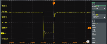

And this is the IIx /START signal. As you can see, it rings well outside the spec, which is why I believe the probing fails.
The signals from the Nuchip are clean, and they are also clean on the inputs and outputs of the G1 buffer. So this ringing has to be introduced somewhere between G1 output and the NUBUS slots. The only other component in series is the RP8 resistor pack. I replaced both G1 and RP8, with no change in behavior. I also checked nearby 0.1uf bypass caps, as well as grounds and other inputs/outputs on those ICs. I'm quite confused as to what could be causing this.
Not sure where to go from here. I could also be going down a completely wrong rabbit hole - perhaps Mac IIx NUBUS is more tolerant than the specs suggest?

I wouldn't worry about the ringing.

Just another follow-up. It looks like C7 must have been introducing some parasitic components (current/inductance?) to Nuchip and/or surrounding ICs. After rescanning, many of the pins that were previously showing some (minor) fluctuations are solid now. Here's an example of the first /START signal after reset - it looks very different (compared to the bottom picture in the original post). Again, the only modification I made is I swapped out UC7.
