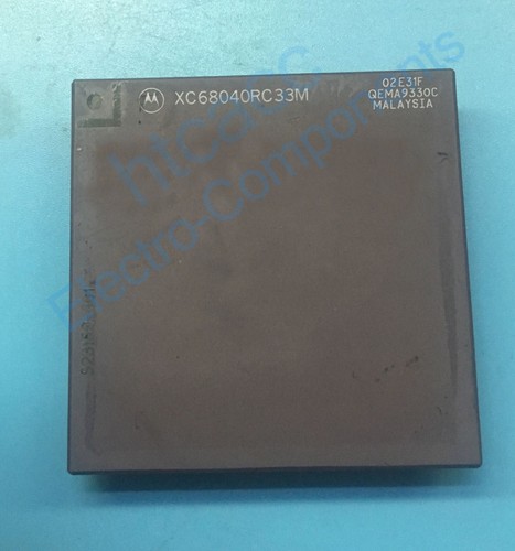

Here's an eBay seller in China offering chips with mask 02E31F. Do these look legit?
I bought a 02E31F MC68040RC40 from ericwoosrarechips on eBay and it was exactly as advertised, not remarked and fully functional. Out of stock right now but more do appear now and then. https://www.ebay.com/itm/383675636030
I'm glad this thread was bumped because I got to learn about what process my cpu is.
From my experience buying various 68040 chips on eBay from a variety of sellers, I would trust Eric Woo 100%, and I would be very , very suspect of any other seller. Especially ones sourced from China. I have purchased some which said California and they drop shipped from China.
Advice for those who are looking for full 68940 chips or higher rated ones than they have: put a notification on Eric Woo and when he lists an item you’ll get notified, and buy from him.

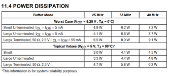

Here's motorola's specs from 1993 (and onwards; unclear what mask this applies to). It can be seen power consumption of the L88M mask is somewhat improved but still a far cry from "runs cool to the touch" :)
Did you measure the temperature of the chip? I guess if we pretend that temperature was somewhere in the middle of 0C and 90C, then 5.85W @ 40 MHz would be the approximate specified power consumption. Thus, your measurement of 3.5 W @ 40 MHz would indeed be a significant improvement.

No, I didn't measure the temperature - my testbed has a heatsink-fan attached to the chip so makes it difficult. Temperature is a function of the thermal conductivity of the die to the case (constant) and then from case to ambient air (modified by airflow, heatsink, thermal material), so for PGA it's very easy to estimate temperature (and distance to maximum permissible temperature) given a known power draw. Motorola has a very thorough treatment of the thermal characteristics of the PGAs. the QFPs don't have that same data, unfortunately, but it's possible to make some educated guesses based on contemporary motorola chips which used similar packaging.
Note that from the data above the "Small" line under typical values represents the expected power consumption. It's probably for the E42/31 mask chips, if i had to guess, rather than the earliest masks that were notable hogs. Note they're specifying TJ (junction temperature) as 90 there rather than ambient=0 as used on the worst case scenario.

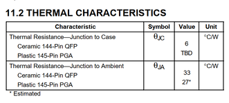

Due to the lack of data for the 68040 QFP, I've been using the thermal resistances from MC68340 as the ceramic QFP package is contemporary with the 040 and visually appears to be the same construction.
junction to case gives the resistance from die to the ceramic, and junction to ambient is resistance from die to ambient air.
These QFPs don't have a lot of thermal mass and worse thermal dissipation characteristics; PGA tested around 23 C/w without a heatsink, per motorola, where we can see a similar QFP is 33 C/w. The resistance decreases massively with a heatsink added which is how this can work at all; there's a nice treatment of the thermal characteristics in both the 68040 and 68030 datasheets. It has a nice analysis of required airflow vs ambient temps vs power to keep the junction below the maximum tolerable temperature.
The tolerable ambient temperature is roughly given by tjMax (110) - powerWatts * thermal resistance C/w.
For no heatsink at 3.5 watts, I come up with a max ambient temperature of -6 degrees C! This does roughly agree with the statement I found on the 68360QUADS datasheet; 68EC040 is specified at a maximum of 3.9 watts and typical of 2.4 watts.
