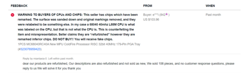

Recently purchased a fleabay 40mhz chip. Marked as:
MC68040RC40A
02L88M
S23159-001
I suspect it is really an E31F or E23G. Obviously a fake, trying to claim back through Ebay now. Do not buy from this seller:
Looks like someone else left interesting feedback after my purchase. I have yet to leave feedback, waiting to see how the seller handles my return first.

I purchased from this seller and messaged them about their chips being remarked. The seller offered a full refund and to keep it.
I did not post about it here because I was discouraged from sharing information about fake (remarked) 68040 chips in this thread.
