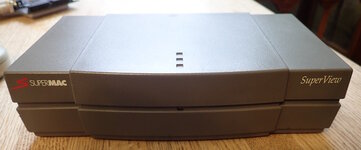

I obtained a SuperMac SuperView that someone sold thinking it was a hard drive.

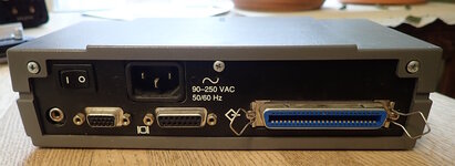

The reason the seller thought this was a hard drive is because this video card is in a standalone case and connected via SCSI. So, it kinda looks like an external hard drive. Conveniently, it features three video out ports: RCA, VGA, and Mac video. It has a standard US power cable connector. These standard connections make the SuperView more portable, as you could go to someone else's office and expect they would already have a power cable and video cable.
Unfortunately, the SuperView only has one SCSI port. So, that means this device needs to be the end of the SCSI chain and any other external SCSI devices must have two ports. This was a problem for testing, as most modern replacement SCSI drives only have a single port.
Underneath is the SCSI id switch. Even though it is in a unusual location, it is still nice that it is included and external.

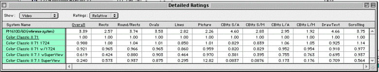

For comparison, I installed the Micro Conversions 1724PD PDS slot video card. That gives us five result sets:
1. Color Classic II System 7.1 with no external monitor
2. Color Classic II System 7.1 testing on the 1724PD video card's external monitor
3. Color Classic II System 7.1 testing on the primary monitor but with the 1724 card installed.
4. Color Classic II System 7.1 testing on the primary monitor but with the SuperView installed.
5. Color Classic II System 7.1 testing on the SuperView's external monitor
As expected, running more than one display slows down the Color Classic II regardless. Yet, the 1724PD runs well and has less than a 8% penalty on the video speed of the main screen. However, the SuperView video performance is poor. Just being attached slows down the main screen almost 40%. Ouch. Running on the external display (note the false Picture results of 12x speed) is pretty slow, mainly due to copybit performance.
I understand the cost of moving blocks of pixels across the SCSI bus. However, I would think primitives would be super fast -- like an accelerated graphics card. After all, you just need to send the command. I wonder whether the driver waits for a completion signal or allows primitives to be queued.
Quarter speed graphics performance would seem unacceptable, but the real-world results are better for non-copybits applications. In practice, it was perfectly fine for most tasks, such as presentations, spreadsheets, and documents. I just don't think it would work well for action games.

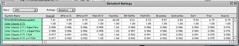

One last note: CPU performance was largely unaffected.
