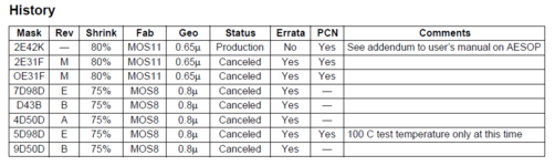

Looking at the Motorola "High-Performance Internal Product Portfolio Overview" document (the document I believe you're referring to), I think by "cancelled" they actually meant "deprecated" or "retired." 1995 was the introduction of the E42K mask, i.e. the fully-qualified 68040. But we know that other mask revs listed there were used. So it's likely a report that any stock of the older rev masks were likely retired from sales/shipping. I.e. all purchases would not be from the mask revs marked "cancelled."
EDIT: here's the PDF
Whether a 40 MHz rated version of that mask rev was produced should be the actual question to ask. Look at Bolle's post earlier on in the thread and see if the accompanying markings correspond at all.

According to that Motorola doc, the second .8 um mask was tested to 100 C, so I'll be interested to see where/if my D50D starts to approach that, as it's a 9D50D, which apparently preceded that test!
Again, I'm sticking to the nomenclatural oddity that "Canceled" means "Deprecated" or "Retired" from sale/prod.
