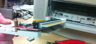

had to knock off the plastic stop
looks like it showed up?  dunno. its a brand new scsi2sd, .w 4gb card
not sure if it has to be set up or what not. but looks like it sorta shows up, might have to use lido for this one.
poped in
standoff hodge poge i used for mounting
so i clipped off the power plug.
