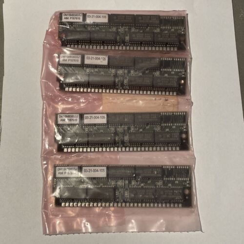

Would this RAM work in a IIsi?
Thats not easy to answer. Infact, with manufacturers changing what chips they use, Its basically impossible to answer.
The best answer I can do is perhaps, but the probability is better if you get 8 chip simms.

I take it back - they're 16mb simms, so you'd need 4 sets

You need 4 matched sticks. Its a bit of a mess in that era of RAM over what does and doesn't work, but I think macs didn't get more forgiving until the Quadras, and even they didn't like some SIMMs possibly.

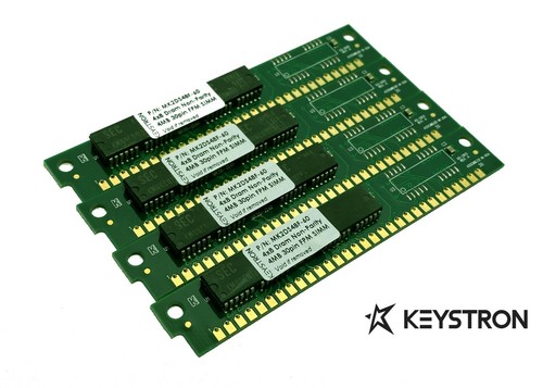

4 of these would work :
And that would give you onboard RAM plus 64MB for 65MB.
