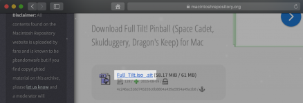

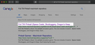

step 1: http://lmgtfy.com/?q=Full+Tilt+Pinball+macintosh+repository
step 2: step 2.png
step 3: step 3.png

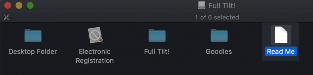

step 4: decompress that file and mount the .iso
step 5: step 5.png

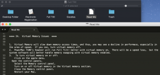

The most credible potential source you cited in terms of VM being off helping anything is the case of the game -- notably, you didn't actually have a link to a PDF of the manual or anything like that

Thank you for providing the detailed information from that Pinball game. When was that game released? My guess is at the time, the presumption was memory amounts were low enough people were actually swapping to disk on the daily, but who knows. I wasn't there when the company decided to write that note. It seems weird that they wrote the note only about the 7100. Were the 6100 and 8100 immune to the issue at hand? Missing details like that make me extremely hesitant to accept it as advice for how to handle RAM in Classic Mac OS for all use cases.
Supports earlier versions of System 7... definitely runs on 7.5.3.  Since they don't specify all PowerPC Macs and just a specific unit, it may have to do with the 7100 specifically and some early System 7 bug.  IIRC, 7.6/7.6.1 ironed out a lot of PowerPC related bugs.  So I imagine a 7100 running late system 7/early Mac OS 8 versions would no longer be affected.  But again, I don't own a 7100 to test that with.  However, I do have a 6100.  If your are really curious, maybe I can pull it out and do performance comparisons on this specific game.  All that is regardless, as it still notes a speed hit when running with VM enabled.  No one wants a pinball that stutters as it travels the board.  Lol that would just be awful.
