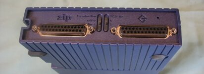

what does the back of that one look like?
edit : theres one listed on eBay as a Zip Plus, and it appears to have the SCSI-ID select switch, but not the termination switch. And the bottom lacks the diagram showing either a SCSI cable or Printer cable.
TonyJay

When you know what you are looking for, this is pretty easy, both switches on the back are a clear indication of what kind of drive you have in hands.
