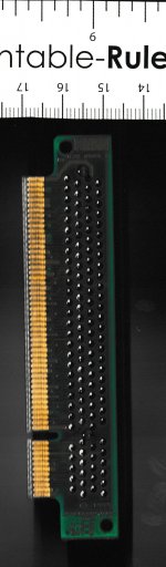

Fabulous! Thank you very much, you've answered so many of my questions. I had a nagging suspicion about the notch I'll need to make for PRAM battery clearance. I pulled the bats from my boards, but still have them, so that's one big one down!
This shot is amazing:
The "sideplane" popped up in my window close enough to life size that holding the cardboard template I cobbled together about an inch and a quarter off the screen matches up almost perfectly. Even the CS2 cutout appears to be pretty close, I threw that on there roughly, expecting to be more than this little bit off!

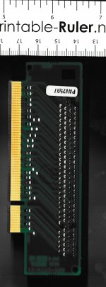

Your pic of the solder side is probably good enough for a rough fit test with my mockup. There's just enough perspective distortion (leaning in building/keyhole type) in your shot to induce fudge factoring. An actual scan of the solder side of the PCI riser as I've illustrated above with the 6400 riser would give me hard numbers for the PCB design. As is, I can file the mockup down to a near perfect match for rough testing. Put the CS2 riser on the scanner at the same time and that will be another good reference for my workup.
Your top view pics cut off at the edges enough that I can't estimate the maximum PCI card length for the TAM. Could you measure the distance between the cover plate's metal shield and the sidewall/backside of the card area at the real of the slot? Looks to be at least a bit longer than a 7 inch card?
Thanks so much!
