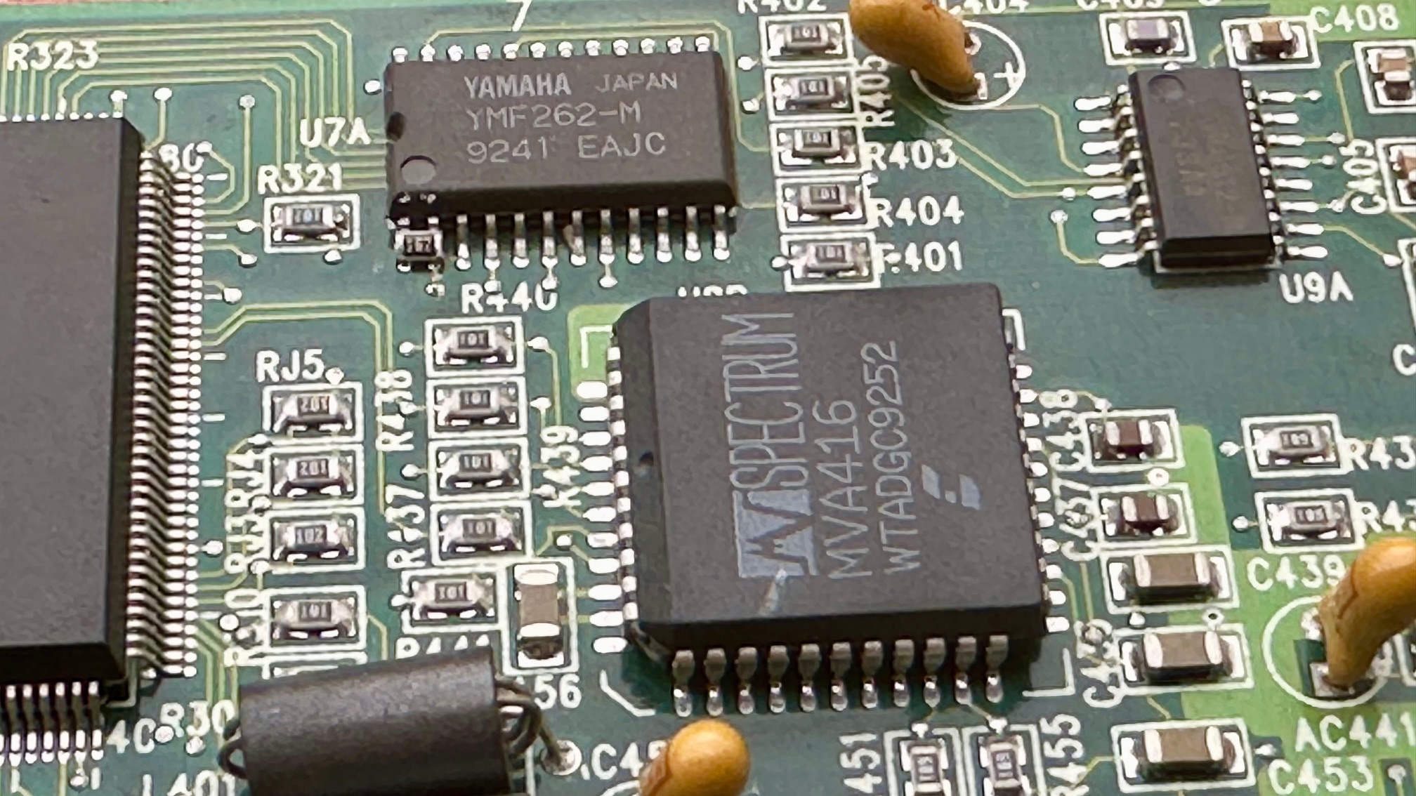

OPL3 pins 4 and 5 go to pin 125 and 126 on the MVD101-D "Spectrum" IC respectively. The chip is definitely hooked up and running, it's connected to 5V from the slot, and the data lines are connected to the MVD101-D as well.
The MVD101-D is the exact same chip used on the PC PAS16. In fact, ALL of the Media Vision chips are the same as the PC card. Which then got me thinking about how the PC version of the card works, and I remembered something that suddenly makes me realize that of course my brute-force didn't work. Even on the PC, you need the MVSOUND.SYS TSR to activate the Sound Blaster compatibility including the OPL. That driver obviously does some magic to talk to the OPL. Might need to see what kind of writes it is doing...
Also, going back to the fact that poking $FE000B88 on the NuBus caused a click on the speaker, that may very well be where to start. Might need to replicate what MVSOUND.SYS does in some way. Guess if I want to do this, I'll need to learn to understand some x86 assembly!
Yup, if the OPL is behind a custom chip, we can't even assume it is memory mapped, so you'll need to work out how the PC version uses it like you say. If you can work out the base address of the MVD101-D by comparing commands that we know from PC and Mac, you should be able to figure where the OPL related commands for the MVD101-D are in the Mac Map.

Form what I gathered while probing on mine, it's just an ISA card with a NuBus interface. I've not access to mine right now to probe the YMC
Also NuBus is endian safe, even maybe little endian on the bus itself.
Does it change anything if you read 8 bit by 8 bit ?
NJRoadfan
The MVD101D appears to partly function as a bus decoder. The PAS16 card's hardware resources are soft configurable. MVSOUND.SYS (and likely the Mac extension) tell the chip where to connect the IRQ and I/O addressing lines of the various parts of the card. Normally Adlib compatible cards wire up the OPL3 directly to 0x388h. Its likely those lines aren't connected at all until the MVD101D is programmed at boot. I'm actually surprised Media Vision recycled this chip for Nubus as they needed to add additional bus interface logic regardless.
demik
Traced the board and can confirm @NJRoadfan findings
The YMF bus lines are wired to the MVD101D AND a 74LS245 buffer (bottom right, AU12F) AND to the MVA508 (mixer chip) through R301-R308 100Ω resistors.
I see no continuity between the YMF and the NuBus part of the card (left). Maybe missed something.
Output is wired to a YAC512 DAC (U9A) and get lost somewhere into the analog domain.
Also there is a "nice" pull-up resistor on the /IRQ line, dunno how it can work that way…
