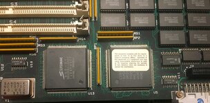

Does anyone have any hi-res pics of the large IC on the Thunder/24 that's just to the left of the Nubus connector?
My card has what looks like a few of the pins on each side of that IC shorted out with super tiny patches of solder.
jeremywork
I don't see any pins bridged on mine...
