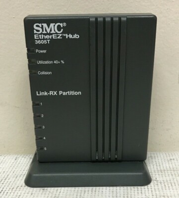

These responses are really helpful. Regarding the hub, would something like this be a possibility?:
SMC EtherEZ Hub 5-Port 10BASE-T Ethernet Hub 3605T
If any of you are wondering why I am bothering with such a fiddly solution as the AsanteTalk, several years ago, before i got this recapped SE/30 board, I used a MacCon IIsi-SE/30 Ethernet Card, which worked fine. When I try to use it in the 'new' board, I get a screen that looks like SimiSimac, so I abandoned it as I had the AsanteTalk bridge available. I'll revisit the MacCon eventually, it sounds like a better solution.

Success!! @robin-fo 's guidance regarding the 10base t hub did it. I was able to daisy chain the hub off of my existing gigabit hub and things started showing up. Also, @mactjaap 's MacIPgw 800k floppy image booted by my FloppyEMU gave me the correct info to put me on the right path.
I had to change to the local DNS of my main router to get DNS to work. These changes were implemented in both the MacIPgw virtual machine as well as the SE/30 MacTCP settings.
I can see and login to the MacIPgw file server running in a virual machine on my Windows 10 machine. I can ftp into it with Fetch on the SE/30 or Filezilla on my Windows machines. I can surf on the SE/30 using MacWeb
