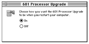

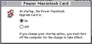

So the Apple System installers include two PPC upgrade control panels, "Power Macintosh Card" and "601 Processor Upgrade". My card in my C650 and the one in my IIci are only recognises by one of them I believe, the "Power Macintosh Card" one.
Does anyone definitively know what the difference between these two control panel is? When is each needed?
My provisional understanding is that the Power Macintosh Card control panel :
Is for the upgrade for the Quadra/Centris and Mac II family upgraded :
And that the 601 Processor Upgrade Control Panel :
Is for the LC (475, 575, 630, 580 etc etc) upgrade :

I know nothing of the LC/II upgrades, but I can confirm that my 040 PDS (PowerPC Power Macintosh Upgrade Card) one only works with the "Power Macintosh Card" control panel.
Edit: Name of the card.
I should additionally add that you need the Daystar control panels for the near identical looking Daystar Turbo 601 and Daystar PowerPro cards for the Mac II family and Quadra / Centris PDS cards. There is one for each type of card.
The Turbo 601 control panel also enables you to skip the memory test and enable SCSI Manager 4.3 if you have a compatible SCSI card.
