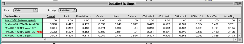

You mention DrawSlab for lines and arcs - did you seem some benchmark where this seems to make a difference? "Lines" seems slower in the results you share
"Accelerated" lines seem to be consistently worse in every benchmark I've tested. DayStar PowerDemo v5.3 goes from 4.4 per second down to 2.6 per second with acceleration on. Buggy implementation? Unfinished work?
Norton reports at least a ten percent decline in line drawing. I retested in System 7.1 (in comparison to System 7.1.2). In 7.1, unaccelerated lines was repeatedly around 1.52. I now need to go back and test System 7.1.2 unaccelerated to see if why that's lower than System 7.1. (Extensions? System? Spurious test?).
In the tests above, notice that LC III using built-in video in thousands of colors seems better at most tests. In fairness, that's half the bandwidth (16 bits of color vs 32 bits of color). Accelerated 1724 still beats built-in video for scrolling and filled rects, even with the disadvantage of millions of colors.
