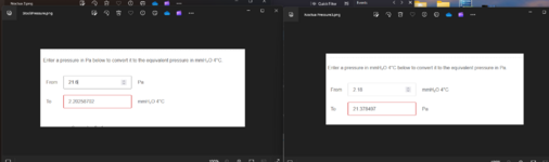

Point taken RE fan, BUT there's noctuas that move more air than stock at the same loudness or slightly less. OR they can be run faster.
Being able to connect via molex is another "bonus". silly soldering wired connections to a molex header... really apple ?
Somebody brainier than me did a side by side noctua vs stock.
From my attached screengrab (converting the noctua 0.391 cfm vs 0.36cfm for stock.) yep fans have come a long way in 35 years. I have noctuas in other very heavily expanded retro machines and they do the job far better than stock)

AndyMc1280
What they don't do is develop enough *pressure*. It's not all about the quantity of air. @Phipli is probably the expert here, much more so than me...
Again I'm probably stinky BUT -
Stock is 21.6 Pascals
Noctua 21.3 Pascals
I can't see 0.3 pascals being a big deal. I also cant see a 35 year old fan producing 100% performance.....
Not trying to be obtuse here but I do my homework ;) The Hard drive isn't going back in. Also having them on molex means a second can be added if necessary.
