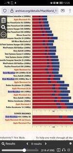

Dove made a processor upgrade that replaced the 020 with a 32MHz 030 in the socket. There were also Daystar adapters that let you plug in a PDS accelerator.
Photos of the Dove device here :
https://www.applefritter.com/content/dove-computer-marathon-030-mac-ii-accelerator-board
Note that isn't the same as a Dove Marathon 030x/SE.
Attached are benchmarks from an old magazine article... Macworld circa 1991?? Its just something I had saved.
