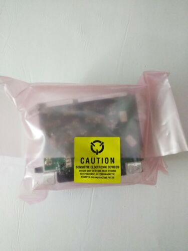

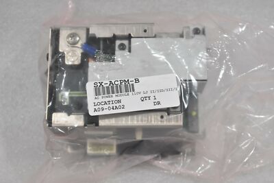

Do you happen to remember if you got the whole unit or just a board? When I look on ebay I have two options:
Or
ScutBoy
It was the whole big brick like the second one you show.
the first one might be the whole thing as well (bad camera angle) but the other is the whole assembly
volvo242gt
Looks like both are. You can kinda see the metal frame that holds the board in place in the first auction's pic.

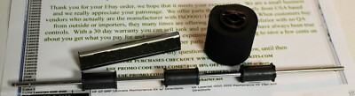

Just received my replacement rubber roller tune up kit today (laserprinterkits.com had a kit). WOW, I thought the rollers were in decent shape... Nope, new ones look and feel totally different. The paper feed one that has little teeth was worn flat, new one looks great. Waiting on the new toner blade before I try it out, but I suspect old rollers caused this issue.
TimHD
Which kit did you get at that site? - seems that the options include more items in each ,eg Deluxe, Ultimate etc (and am wondering if I just get the "ultimate" pack to be best placed in future!)
Johnnya101
Actually, I got it off eBay, figured linking the site would be better because nobody likes eBay's fees. I got the deluxe kit, I don't see a supreme kit?
The eBay listing seems to be cheaper if you want the CD. Otherwise, get it from their site.
Can also get individual parts. Definitely stock up on parts, who knows how long we will be able to get them for.
