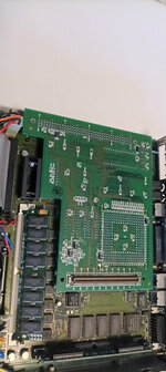

I am installing the card on my SE/30 (labels say Booster 40 and CL-40-40) and I see a connector on the back which I had not noticed - I wonder what for? Any clue anybody?
EDIT: this does not fit in a SE/30! the RomSIMM is in the way!
Now I wonder where I could put it :D it has a 120pin PDS plug so no LCs / older SEs I guess - maybe it will fit in a IIci in the end?
micheledipaola
Meanwhile, the CL-40-40 version of Interware Booster 40 sits comfortably in a LC III / Performa 450 which has a double length PDS slot (96 extended to 120 pins) :)

Nathan_A
Replied in DM too, but... yep 👍. You figured it out. The slot on the back is for cache (mine has a 128k module). Mine came from (and will go back into) a Color Classic II. So, ostensibly it works fine with a 33 MHz bus too if you wanted to do the LC III to LC III+ mod to your machine.
I don't have any software for it that I know of. Though I suspect it's on the HDD of the machine I purchased, so I may pull that out and check if it still works.

@micheledipaola -I was gonna say, that looks like a card for one of the LC's! I have a CV 40-40 Interware Booster myself; somewhere I have the cache card for it. But yea, that connector on the back of it is indeed a cache memory connector. IMG_20211128_163441.jpg
