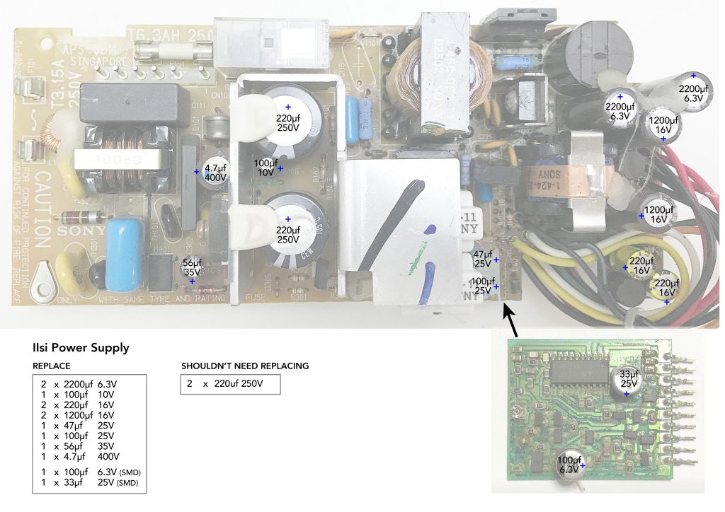

So it depends if they did a full recap of the PSU or not. If it's the Sony unit, there is a small daughterboard in there which handles the soft power stuff.
3lectr1cPPC
Soft power board has been recapped, I checked myself. It looked pretty good when I looked at it but I'll bet that's where my problem would lie. I can get photos of it later but honestly it runs ok without soft power function so I might just leave it as is for now, instead of dealing with the dreaded IIsi power supply.
