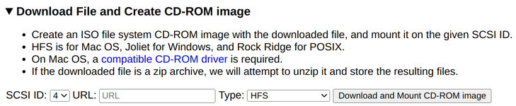

In the web UI of the RaSCSI, there's an option to grab a file from a URL, then convert that into an ISO, that then can be mounted as a CD-ROM on the Classic Mac. Or the other option as you mentioned, the AFP server built into the RaSCSI
