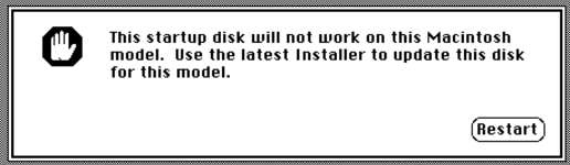

@mihai , well done on getting Mac OS X 10.0 to 10.4 running on emulation. Particularly interesting to see the iMac G3/233 being supported. The reorganisation of the machines makes sense. I keep wondering, Mac OS 8.1 to 9.x don't seem to work on the 6100 emulator: it keeps saying things like:
(Mac OS 8.1) or:
(Mac OS 8.6).
So, is the major problem that they don't have the appropriate System Enablers in the System Folders?

I built those images a while back (for Basilisk II for 8.1 and SheepShaver for everything later). IIRC I did a universal install for all of them, any ideas for what enablers might be required (also, I thought they went away with later OS versions)?

The 6100 booted 8.1 for me in Infinite Mac
https://infinitemac.org/1998/Mac OS 8.1?machine=Power+Macintosh+6100
but I think it had to boot 3 times to get to the Finder? That's weird. Is it starting with empty PRAM that needs to be setup?
8.6 HD hangs on the 6100 (doing printer port AppleTalk stuff) but the CD should boot.
DingusPPC needs to be modified to properly emulator a printer port or ethernet port that doesn't have anything connected to it.
I didn't realise/forgot Enablers went away after System 7.x. I think I was a bit confused, because late versions of Classic Mac OS seemed to need matching Mac OS ROM files with the OS, at least on New World Macs.

OK, so this is where it gets odd. I tried your link, it worked on my Mac mini 2012 under Catalina and Chrome. Then I tried it on this MacBook M2 under macOS 15.3.2 and Safari and it was fine.
Then I tried these variants:
  1. No Saved HD - fine.
  2. Ram reduced to 24MB - fine.
    1. After booting the first time I enabled VM and rebooted, then I got the first error message below.
  3. Same as (2), but booting 7.5.3, then turning on VM and rebooting. Worked fine.
[Error from https://infinitemac.org/1998/Mac OS...wer+Macintosh+6100&ram=24M&screenSize=640x480 when restarted after enabling VM]
[From: https://infinitemac.org/1996/System...wer+Macintosh+6100&ram=24M&screenSize=640x480]
Seems to be an issue with cross-region DMA (Power 6100 has multiple RAM regions because parts are not contiguous or are mirrors of other parts). I got a similar abort with selecting 264 MB but not 136 MB RAM.
Mac OS 8.5 appears to hang too.
Yup, same issue has 8.6 with the AppleTalk/printer port. 8.1 AppleTalk/printer port handling is different and doesn't hang.
