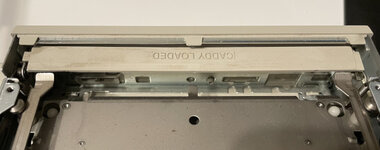

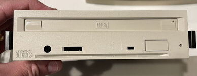

CD Drive - I was a little skeptical about my CD drive. The front had a white sticker on it that I removed and behind that sticker are opening for what look like a headphone jack, volume knob, and LED. None of those pieces are installed.
I thought maybe they broke off. Tonight I removed the cover of the CD drive and I saw these pieces were seemingly never installed!
Is that normal? I would guess yes since they are covered by the drive bay cover.

Yeah that's normal. It's because the same drives were also available as an external unit which did have those features. To save money they used the same bezel internally but just covered stuff up.
Is a fully open/exposed drive bay cover available that would allow CD drives with trays?
Yes, a bit hard to find these days but someone on the forum might have one if you ask in the trading post forum - or you can 3D print your own, I think a model has been made for the tray bezel.
Another option is getting an external drive.
This is normal, they're all like this. There should be a bezel over the front which meant you couldn't get to the headphone jack, so costs were saved by not fitting one. There is one on the back of the computer for the whole system including cd audio.
