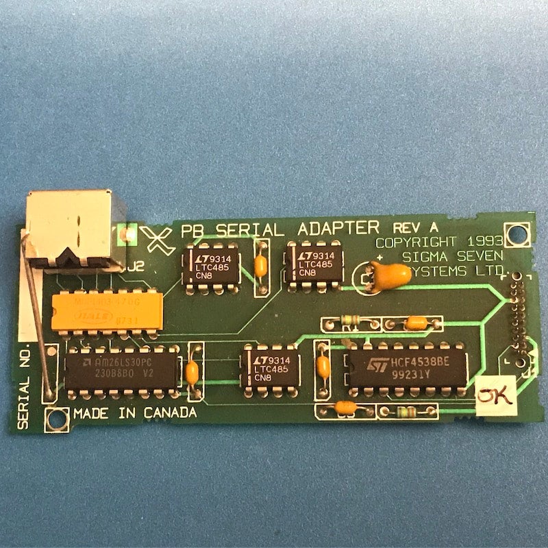

Does anyone have one of the "PB Serial Adapter" that goes in the modem slot of 1xx series Powerbooks as described here:
I'd imagine that it has some minimal amount of logic onboard (maybe voltage shifting?) but other than that would be pretty easy to clone or replicate in functionality.

Amazingly, James from Seven Sigma Systems got back to me and actually has components to build these still!
Also directed me to a website with pictures of the device:
twelvetone12
This thing is interesting, it ha three rd422 transceivers? Does it allow localtalk on the modem port? But I'm not sure how it works, because unless it patches AOn() the system software will power off the modem when switching localtalk ports. And I'm not too convinced about the better performance part, at least electrically the two ports are basically the same ;)
I would buy one if he made them available again. Can you direct him to the forum page?

I wonder if it is possible to do LocalTalk on this adapter. It has an awful lot of transceivers! The market it for the PowerBook 150, and with my machine the network control panel refuses to switch LocalTalk to the modem port. I see they had a control panel for this adapter, so I wonder if they did some more magic.
David Cook
Check it out!
James is definitely still around. I purchased a pair of the adapters from him. I'll post more info after I install one.
twelvetone12
Ooh cool! James is really nice, I wrote to him asking for the control panel for the PB adapter (I wanted to do some testing) and he very kindly sent me a copy.
