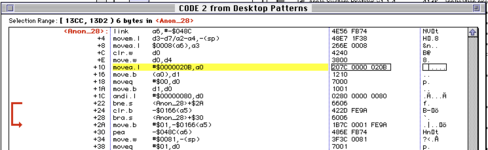

This photo shows the Desktop Patterns cdev contains both 64x64 ppats, and 8x8 PAT#s. It reveals either one set or the other but it is doing a different check than Machine ID, I guess.

It checks the highest bit of low memory $20B, which is the SPMisc2 byte of parameter RAM. It then sets the program global variable -$0166(A5) boolean based on that bit. Everywhere else in this code, it checks that boolean to decide to use ppat or PAT#.
Now we just need to find out what sets or clears that bit.

That low memory global is called pCDeskPat in this usage. Inside Macintosh says the following about it:
The notation [Macintosh II] may be a color quickdraw issue or a ROM support issue. It might be interesting override the Desktop Pattern code and see if it crashes -- or if support had been added in the system even on B&W machines.

Make a copy of the Desktop Pattern application. Open it in ResEdit. Open CODE resource 2. Change the '66' in the code below to '60'. Save. Close. Run it.
croissantking
Brilliant detective work, @David Cook. I can confirm it works (see photo).
Unfortunately, the set ppat does not persist through a restart. Perhaps Desktop Patterns is not correctly storing the ppat in the System file, only in RAM?
Cool!
Checking the leaked system code, there are a bunch of patches related to pCDeskPat. They patched the Mac II ROM, DisplayMgr, and WindowMgr. So, it looks like the retention issue is a system/ROM bug.
