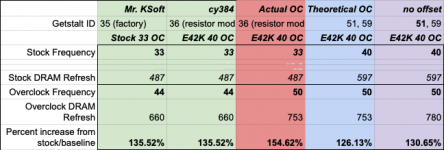

I got impatient excited and wanted to test the WombatLegSpeedBump [Gestalt ID 51 + 20 Mhz oscillator + 40Mhz CPU] tonight...
config table[...]
Code:
@bump40Config    dc.w    %0000001011111100
wombat-hax               -----001011110100
refresh table[!]
Code:
@dj40Refresh    dc.w    597    [0000001001010101]
wobat-hax                      [----001001010101]
I think we're in business 🤩 We're running the correct DRAM refresh register!
I mean, we know that 650s and 800s both can do 660 (what the heck is that number to be measured in anyway, Hz? KHz?), but now we're moving beyond. I mean, an 840av can go to 48Mhz clock / 722 refresh it seems...
It think it is the number of clock cycles between refreshes. 40 MHz / 660 = 60606 Hz. 1/60606 Hz = 16.5 uS, which is about the amount of time recommended between memory refreshes. (My memory says 16.6 uS, but I used to do DDR2 professionally, so I could be confusing them. I'm too lazy to check a datasheet)
As you make the clock speed faster, that number needs to be larger to maintain a constant 16.5 uS, otherwise you start refreshing more often than you need to and lose performance.
E.g. 50MHz / 660 = 75757Hz 1/75757Hz = 13.2 uS
Working backwards: 1/16.5 uS = 60606 Hz; X / 722 = ~60606; X = 60606 * 722 = 43.75 MHz.
Looks like they may have had a target of 45 MHz for the speed bump.
If you want to target 50MHz then 50MHz / X = 60606 Hz; X = 50 MHz / 60606 Hz = ~825 for 50 MHz.

Going off of this calculation in the module:
(Refresh = (MHz * 15.6 ) - 27)
The Universal module comments at the refresh table:
DRAM refresh cycle times assuming a 15.6µs refresh period
Code:
;        DRAM refresh cycle times assuming a 15.6µs refresh period                <H25>
;        (Refresh = (MHz * 15.6 ) - 27).  Fractional parts are rounded DOWN        <H25>
@djRefreshTable
@dj20Refresh    dc.w    285                        ; (20MHz * 15.6µs) - 27            <H25>
@dj25Refresh    dc.w    363                        ; (25MHz * 15.6µs) - 27            <H25>
@dj33Refresh    dc.w    487                        ; (33MHz * 15.6µs) - 27            <H25>

I still think it's the number of clock cycles between refreshes. I assume there's a counter in the memory controller which takes that value, counts down 1 for each clock cycle and refreshes the DRAM when it hits 0.
However, I may have done the math wrong. I overlooked that 15.6uS figure. Try redoing my calculations using 15.6uS instead of 16.5uS.
There shouldn't be an integer offset (-27) involved unless....
They're offsetting each bank's refresh from the other banks by some number of clock cycles.
That's probably not it. You need a pretty intelligent memory controller looking ahead for that to be better than all at once.
So, I would guess that -27 is just a safety factor. They calculate the proper number of clock cycles between refreshes and then subtract 27 for margin. I have no idea why they would choose 27 though. I would expect a number sliding with the number of clock cycles to keep a constant time.
Unless it takes the memory controller 27 clock cycles to set up the refresh for some reason. That would make some sense.
Dug out a datasheet for that generation of DRAM. For detailed explanations, Micron's are really the best I've found.
The requirement is refresh every 64ms, but refresh only occurs 1 row at a time. For memory with 4096 Row addresses, that converts to .064/4096 = .000015625 = 15.625uS.
Most DRAM contains an internal ROW or RAS counter, so the memory controller just needs to send the refresh command every 15.6 uS and the DRAM does the rest.
Seems like it would get refreshed too often for smaller memory sizes that might have less than 12 rows.
So is the question now: can the memory controller handle a refresh of 753 (780)?
Or
Is it a question of the DRAM being able to handle that refresh rate?
Or is it late, I'm tired, and I'm barking up the wrong tree when you've already told me "it's that tree over there?" ;)
50*15.6 = 780 - 27 = 753
I did the math based on your formulas (I think) using 15.6µs and have come up with the same refresh number (without the offset amount subtracted): 1/15.6 = ~64102.56 hz ; 50/64102.56 = ~0.000780 (780)
Even without the offset, it looks like we're within the same window of tolerance for the other overclocks
If if can handle a number larger than 511, it should be able to handle any number up to 1023.
I could be wildly wrong, but I envision a refresh counter in the memory controller being set at initialization time. The counter must have enough bits to count a large enough number to handle the countdown.
8 bits would give 0 - 255. 9 bits => 0 - 511, 10 bits => 0 - 1023.
If it definitely supports any number larger than 511, then it certainly (well almost) must support numbers up to 1023.
Gotcha. Well, if that's sorted, I suppose that it's a matter now of testing incrementally up (or down) to see where any failure points manifest.
